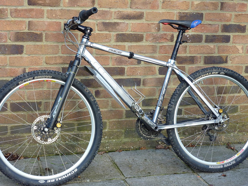

What model is my Pace RC200
serial number will help, and cross reference against the pace serial numbers thread on here somewhere, it has an index of serial numbers against model, just find where yours fits in.
i think disc mounts were f6 onwards but not certain
Frame no. should start F* (6/7/8).
Looks like an F6 that's had an Fi disc mount added.
F8's had triple butted top and down tubes and butted head tube and bottom bracket shell and seat stay disc mount and canti mounts.
F7's had double butted top and down tubes, can't remember what the bb shell and head tube were like but they had a chain stay mounted non IS disc mount and canti mounts.
F6's had db top and down tubes, plain head tube and bb shell, bolt on canti cable stop on wishbone and bolt at bottom of seat tube for an e type front mech. Can't remember if mine had additional bolts on the wishbone and seat stays for the original rear crud guard as my previous F5 had.
The only Pace with a disc tab there as standard is the RC200 F8
file.php
But then it would have tubing as mentioned above
Sorry, only saw the 1st picture and line of text when I looked this morning, it was early, I must have still been asleep
