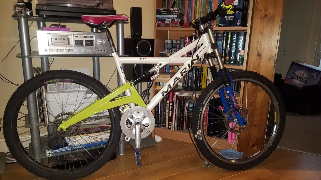

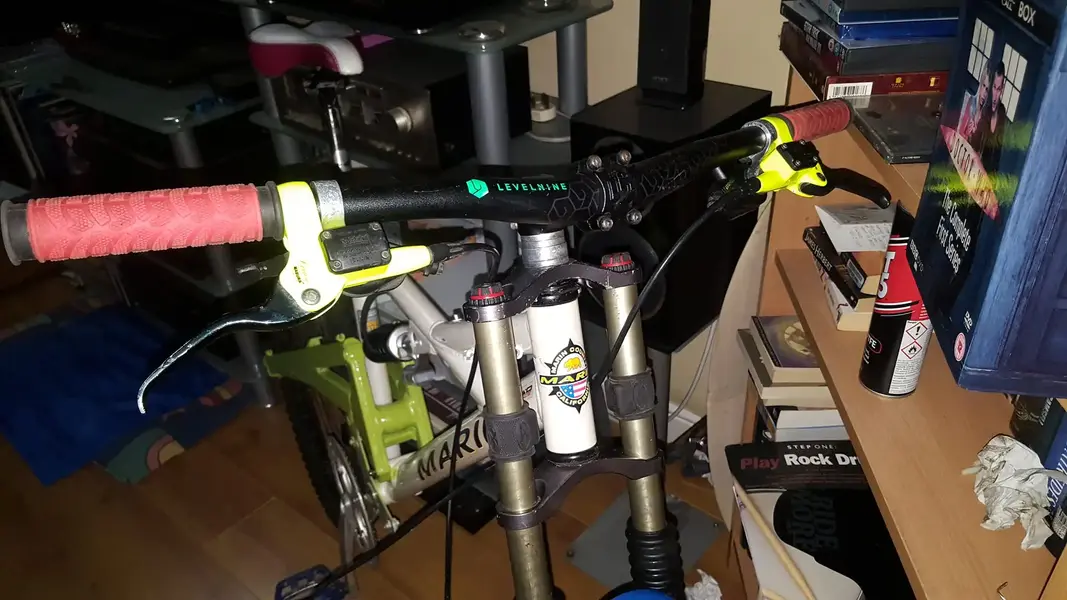

Here are the last couple of photos I took - the swingarm was repainted with Spray.Bike which was great to use and seems pretty durable, though actual riding will be the real test, and since I took these the bike has gained a proper saddle and a cheap and cheerful dropper ( the seat tube ID is surprisingly 27.2! ) and a new chainset ( sticking with 3x ) I am currently waiting for a new rear mech hanger and some brake fluid.
Once I have decided if I am happy with the fork I will either paint it to match the swingarm or replace it. The chain retention device will be going as well, once I get up the courage to get the BB off.
BOAB
