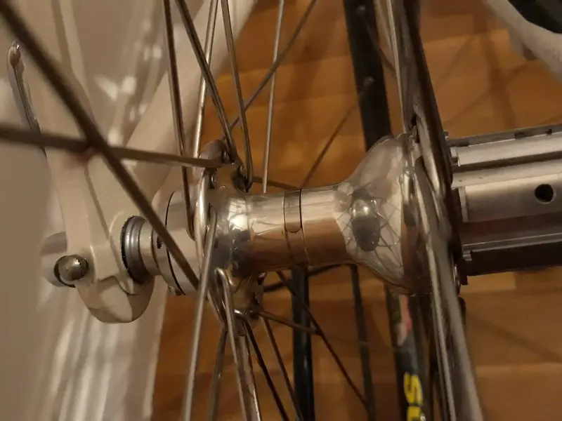

This is a question I never had resolved myself. On the RD, bolts are clearly titanium , but speaking for the hubs, the axle to me looks aluminium, same as the body and the freehub... so is there any titanium on these hubs ??
Obviously I’m looking at a pic on a screen here, but the hub body does look like aluminium. Given the higher strength and stiffness of Ti compared to Al, I don’t know why you’d make the hub body that chunky if it were Ti. Is that sleeve in the middle Ti? Lol.
Record 'Titanium' was the groupset name because there were some parts made from Ti. Some parts - not many. RD bolts, pedal axles, some of the larger sprockets of the cassettes and possibly (but I doubt it) the bottom bracket axle. As far as I'm aware there are no Ti parts in the hubs.
