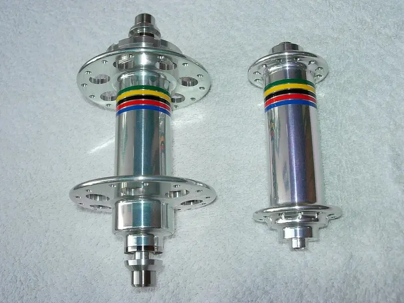

The only reason I ask is that I have some lovely custom hubs and wanted to make the most of them by getting some very good tub rims in 28/24.

These are the hubs that were custom made for me.
24H front and 28H rear.
Kind of lovely, so want to build them into something strong.

Think I'm going to stick with the GP4s unless anyone has some 24 and 28 hole tub rims for sale?
