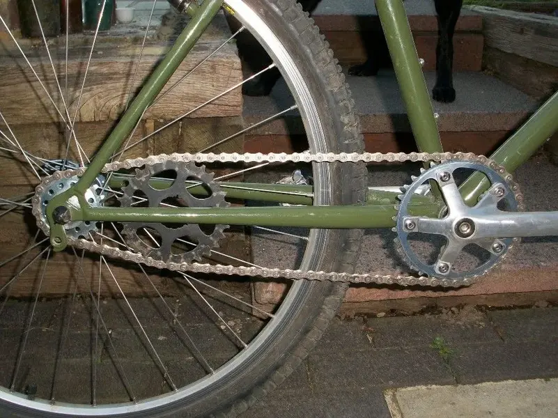

used the ghost ring method ......... one snaped in half :( ......... and two fell out in the woods :( lost forever ..... now use a sprung tensioner and it works just fine :) but as the others say, dont over tension it or the spring may snap !!
I never thought it would be easy but it does look cool :lol:
Yeh for sure looks the biz 8) and on open ground it never came out .... apart from the one that snaped !! but there downfall is trees, logs, jumping ect, the sudden shock on landing shakes them out :(

this has been quite successfull
and i have also used a ghost gear but it never jumped out on me - chainline was spot on
