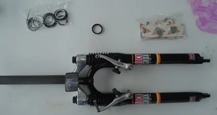

Here is a pic of the fork. I am not looking to replace it, only asking about options if I wind up having to. As indicated, the fork has never been serviced. I've periodically lightly oiled the seals with the Teflon fortified oil, but the fork itself has never been disassembled or had the oil changed.
In the first 12 years, the bike got ridden less than 100 miles in total. In the last 2 years I've ridden it about 2,000 or so. It seems to work fine. But mindful of regular service needs now that I am riding a lot of miles, and considering its age, it probably needs to be have normal periodic maintenance service. If anything is found amiss I may be SOL.

So I don't want to write it off, just trying to anticipate what I may have to deal with. To that end, a couple more questions if I may. I'm going to post a couple more pics. How do I confirm that it is a 98 RS? Can anybody assist me with this? Does the serial number, or decal style identify the year?
In theory I should be able to service the fork myself. Any tips, suggestions, or service cheat sheets available?

Yes it is a 98 Judy XC. The owners manual is in the archive here
http://www.retrobike.co.uk/gallery2/d/6 ... 7e6932c1fc
You'll be pushed to find parts if you need any. This place http://www.suspensionforkparts.net/esho ... at&catId=9
doesn't sell the specific elastomer you might need, although I guess it might be possible to modify one designed for another Judy. Maybe seals are fairly standard, but bushes could be difficult. The cartridge may be ok, but if not you won't find a replacement (earlier years ones are not interchangeable).
To be honest, if it needs replacement parts, it's not that good a fork anyway, so it isn't really worth it.
If you look on eBay for a Fox Float with canti mounts, you should find some in good condition coming up quite often. I doubt you'll find one NOS though - why would such a good fork have lain unused for so long?

There is no oil change as such.
You take the top caps off and take out the spring setup, clean it up and put a bit of Fork 'Grease' on it.
You pull the legs off (bolts at the bottom)
Clean it up, drain/swill the lubricating oil at the bottom out.
For a more though clean:
If you want check the damper at this point. Undo the circlips on the bottom of the stanchions. pull the dummy rod out of one leg, clean it up and lube.
Carefully take the Damper out, check it over clean and lube.
Fell if there is oil in it or not (i.e. resistance and even all the way trough).
Lube it all up.
Stick it back together.
If you want new Dust wipers then you can buy them, the look for the right diameter one and the XXX kit should do as it's a combined brace/lower leg setup.
Bushes, you would need the tools and a bit of luck to find some. Best go raid you local bike stores. But by this point I'd bin them and you would know if you needed them.
Grease everything up, drop the required cc of lubing oil in he bottom if needed or do it anyway.
As for the same fork new I wouldn't bother even looking, you're at £100 odd over this side of the pond if one happened to ever turn up.
Get some Bombers if you want to stay period, spares are readily available for them.
