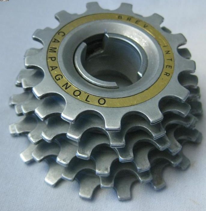

Campagnolo ergal alloy freewheel is an obvious choice.
Everest would also do along with maillard
Hard to find at a reasonable price; many seem to have been butchered by people getting them off ...
Here is mine that I got for a 100 quid for a special project fit the LF record hubs I have perfectly
Back in the day I used Regina BX with no problems on these hubs - I seem to recall just reaming a remover out.
Where did you get that for that price Nob?
