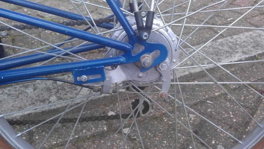

Hello,
I have these rims on my Pashley Ladyback Tandem. It probably dates from the 70's or 80's at a guess.
Theyre 26 x 1" 3/8. Does anyone know what they're called and where I might find some NOS ones?
Thanks
GasPipeWarrior":2k61dxe3 said:
The pattern on the edge of the rim looks like Rigida Superchromix, but usually that's etched into the surface of the rim.
You can still get 590 rims from SJS Cycles.

The look like steel rims. They will be ghastly in the wet on a solo, so must be truly alarming on a tandem. :shock:
Replace with some aluminium ones as said above. 26x1 3/8" are an obsolete size, so consider shifting to something like 650b at the same time.
Ha ha, yes stopping does leave a little to be desired however it has Weinmann 750 centre pull brakes on both the front and rear as well as a hefty drum brake on the rear wheel.
The rims definitely look to be Rigida Superchromix'esque.
I mainly use it to take my daughter to school (she's 5 and rests her feet on the top tube) as well as weekend pub rides. I leave it at home if it's raining :D
It's also great for riding as a training bike one up. After you've covered some serious distance on this thing, you fly on anything much lighter.
As hamster says put alloy ones on.We ride tandems all the time now and I know how much hammer the brakes get. On a long steep hill the hands get quite sore with the lever pressure and that is with modern brakes and alloy rims. Steel rims are useless in the wet even with multicondition blocks.We lost a friend a number of years back when his bike picked up speed in the wet and dumped him over a bridge . That had steel rims. Faithful restoration is fine but there are some things that are simply not worth preserving
