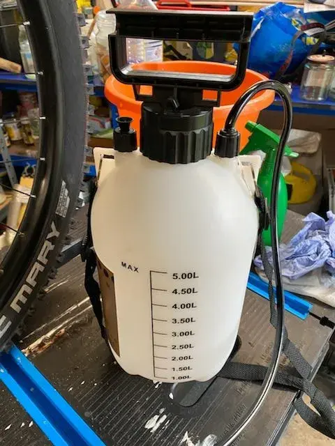

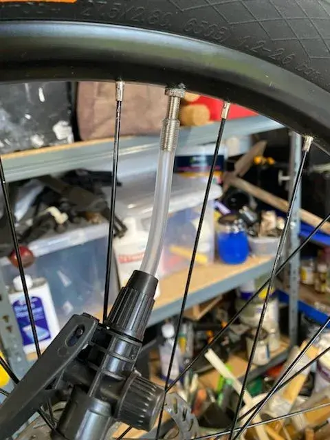

I have now fitted my Magic Mary and used Orange sealant because that was in the local shop. I made a tyre booster with a garden sprayer and after a bit of trial and error have the technique sorted. The rear tyre was fitted when I bought the bike second hand and I topped that up with Stans (that was what was in it).
