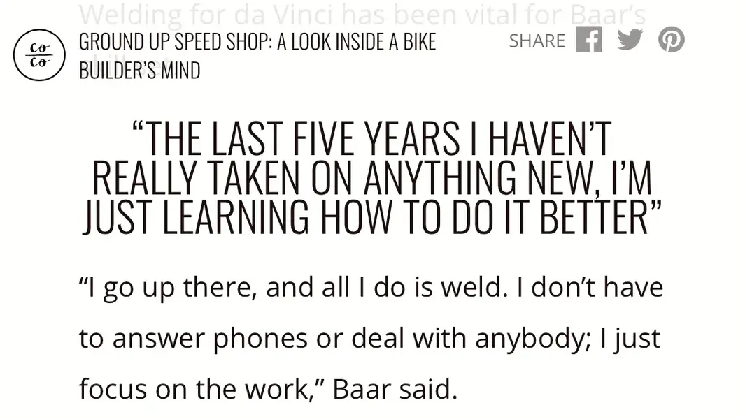

He builds all the frames for Da Vinci tandems, so doesn't have to do the up front fabrication etc, just weld weld weld...refine, refine, refine...

How cool is this.... zen master
