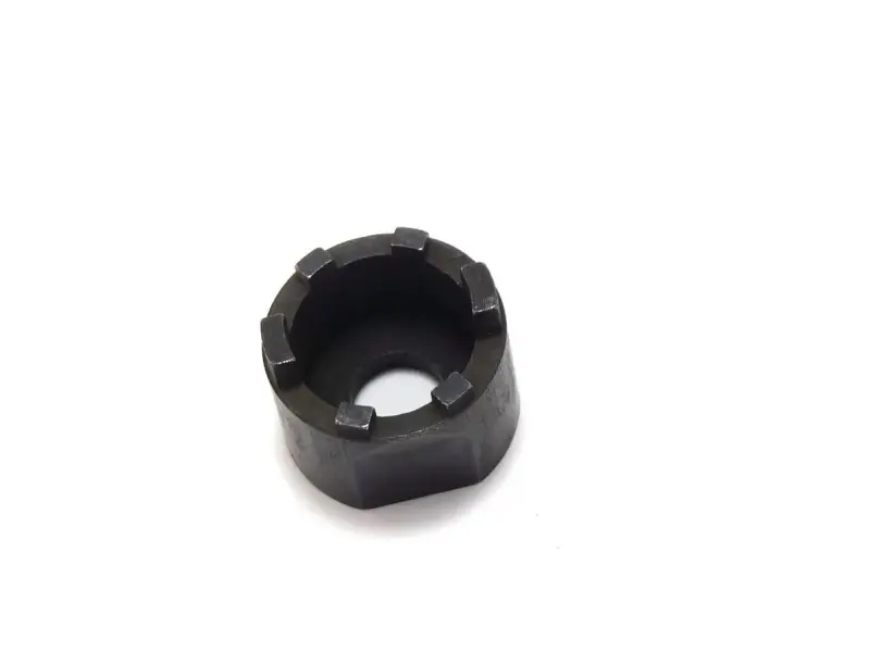

The only reference I can find to 'six prong tool' <insert suitable joke/ double entendre here> is a Suntour 'Microlight' as pictured

From the BMX world
Do what this utube guy says to remove freewheel. Although he does dismantle the freewheel you can rebuild it if you do not lose the ball bearings. I've done it myself and it works.
/www.youtube.com/watch?v=WsVL1XqZve8
