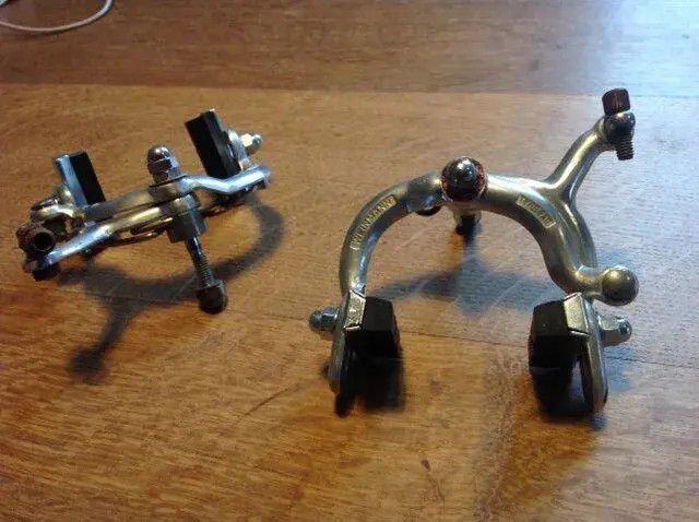

I have a pairs of weinmann type 730 unfortunately the reach is to long ( 55mm - 70mm), I am wanting preferably the same brakes (with red weinmann washer/ could be type 500) that accommodates a 50mm drop from bolt hole to center of rim. Can just buy or we could do a swap.

A bit miffed about which version of the 730 brake you've tried to use- any chance you could add a pic, since it sounds quite like you've already tried the shallow drop version?

I have these 730 brake and the reach is 56mm to 75mm which is to long. I need a brake that falls into the 50mm reach category.
I found this table for weinmann brakes online -
TABLE OF BRAKE REACH
MODEL MINIMUM (mm) MAXIMUM (mm)
400 40 54
500 43 56
730 56 75
So I would need the type 500 model
Ok, it's just that I know the 730 model comes in two different sizes, but now that you've pointed out that the other models are smaller sizes, I'm guessing the other 730 would be larger than 53-76mm size.
I do have a set of 500's, but let me know if the above chap doesn't turn up something more to your liking/better performing.
That sounds good, would prefer to replace The ones I had, could you possible post a picture of the 500 brakes? And do you have a price? Thanks
