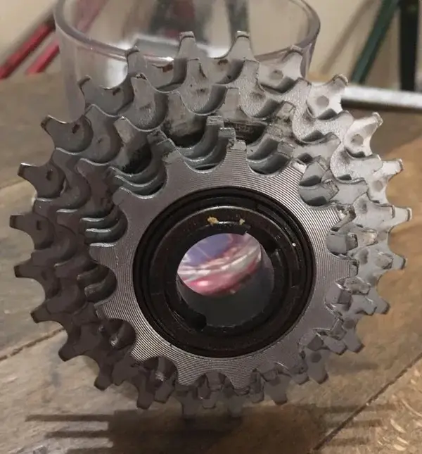

13/24 six speed. Looks narrower than 5mm. About 31mm total.
Will be 5.5mm or 5.0mm (looks like a new winner and they had std and ultra)
Can you post a pic of other side? Does last cog have an A on the back of it?
There is an A on the 24 but can’t see what’s on the 13. £25 posted if it’s any good to you. jm.

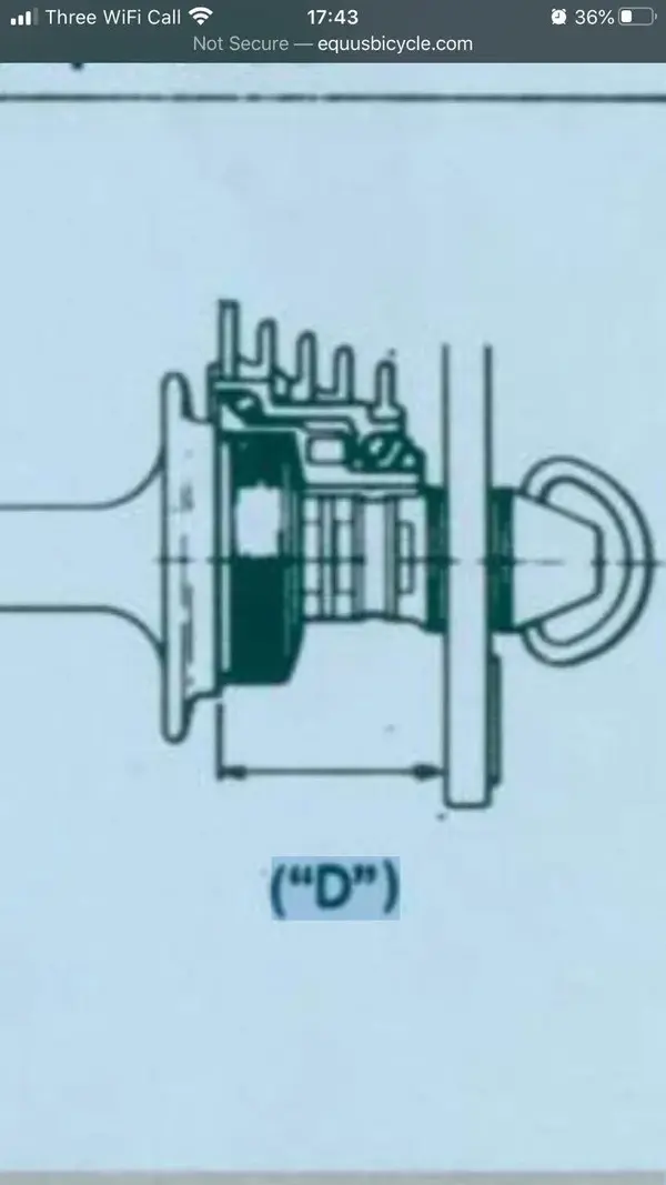

Ok aparently D dimension in photo below is supposed to be 30mm on a 6sp ultra and 36mm on wider spaced.
If possible to check that would be awesome as need the ultra spacing

Isn't that a hub measurement and not the freewheel. I thought the idea was to use a narrower chain and cogs closer together to pack in more gears into the same space?
