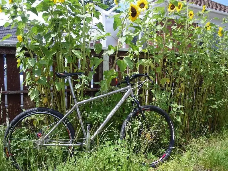

This was my Christmas present to myself :)
Frame: Voodoo D-Jab
Fork: Salsa Cromoto
Headset: FSA
Stem: Easton
Handlebar: Ragley Carnegie
Brakes: Avid BB7
Brake Levers: Avid 7
Cassette: 16 tooth
Chain: Sram PC1
Cranks: Middleburn Uno
Chainrings:Middleburn 32
Bottom Bracket: Shimano UN52
Pedals: Shimano LX
Rims: Stans olympic and 355
Hubs: Hope trials singlespeed rear Hope Pro II front
Tyres: Maxxlite UST
Saddle: Selle Italia flite
Seatpost: Generic 27.2

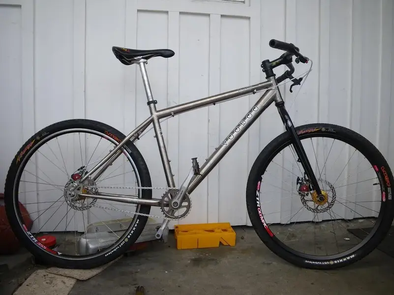

I do note that chiringuita's voodoo has a brace by the rear disc which I do not have....

There are four different models:
From 1995 to 1999, was manufactured in Taiwan by A-PRO Tech.
From 2005 to 2008, was manufactured in China by Hang Lu Sports, Beijing.
From 2008 to 2009, was made also by Hang Lu Sports. The sliding dropouts are different and has a brace by the rear disc (this is my frame). :roll:
From 2009 to today, is manufactured in Taiwan, I do not know the factory. :(
