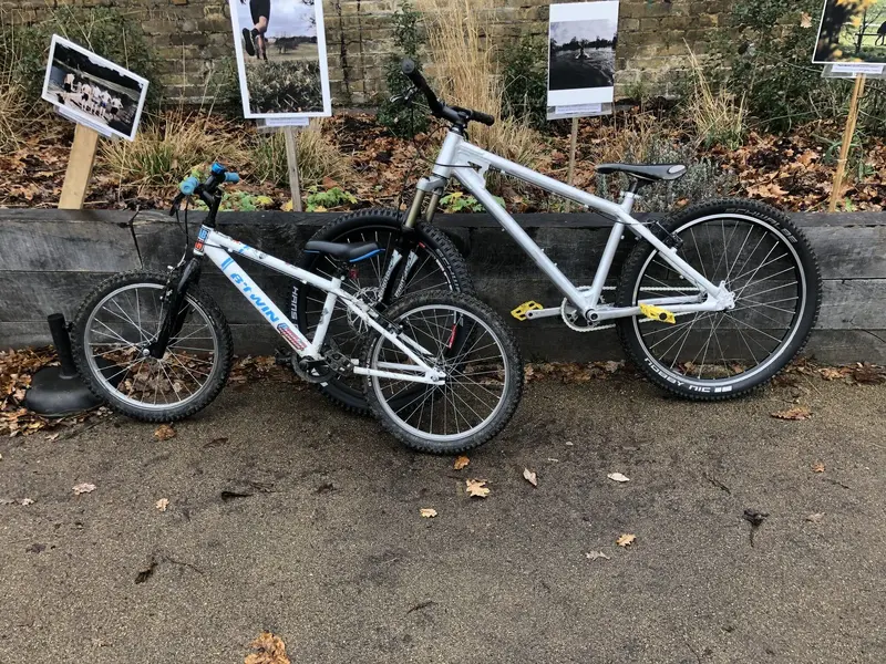

Any pics? I bought one of the disc only ones last year but not been happy with the bits to build yet. I was tempted to build another for my partner. Is this for you? Jack Flash seem pretty long for a jump type frame, partially why I went for one, so short stem either side of 50mm and wide bars should do it. What is your daughter on? Mine's same age and seems to have shot up recently and technically outgrown her most recent Frog!!
It is for me. I have a long spine and short stumpy legs so it suits me just fine. Not a great picture, but here it is, along with my daughter’s B’Twin (Decathlon) singlespeed MTB. Since this picture was taken, the stem has been swapped for a 50mm FUNN stem, and the freewheel for one of the lovely, seemingly bombproof White Industries ones. More pictures to follow sometime soon.

Looks ace, Nice build and good use of V brake mounts!
