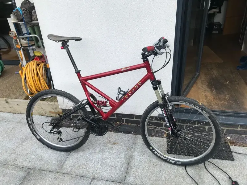

I have a 1995 vintage Voodoo Zolop which I’m still enjoying.
However the main pivot bearing where the front and rear frame section join
is getting loose ie moving laterally which is less than ideal.
Can anyone identify the bearing for me please so I can source a replacement?
I’m told all theses bearings have a four digit ID code which would also help.
All help/suggestions (other than get a new bike) appreciated.

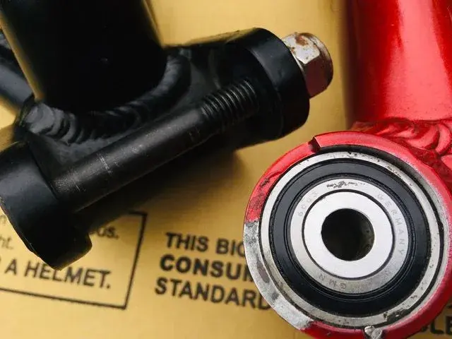

Re: Voodoo Zobop Zolop Joe Murray bearings
Just for the archive record the GMN bearing is marked 6003 and I think it’s a 2RSR type although the latter is not stamped on it

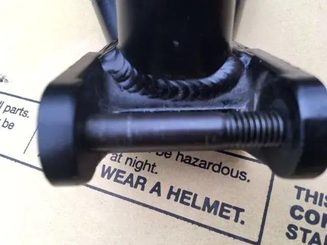

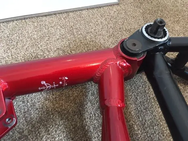

Before going any further with mine I’ve checked the following
Pivot bolt for wear - None what so ever
The Bushing - Nil Wear
The Bearings - Spin freely
so all good - just need to push them out and transplant or buy new bearings and just use the bushing and pin bolt, looking on line this appears to be them but made by FAG so comparable if not better quality http://www.bearingshopuk.co.uk/6003-2rsr/

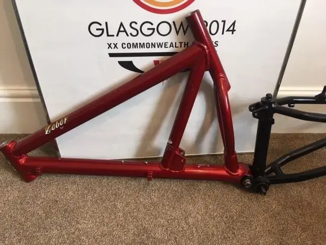

Looking at your frame it’s appears to be a 20 inch and this is an 18 so moving the parts over and use the whole frame isn’t going to be an option given the length of seat post you’ve got going on there you need a big frame.
Donar frame packed up courtesy of a Mongoose Box from Halfords and being collected tomorrow so you should have Friday I reckon.
