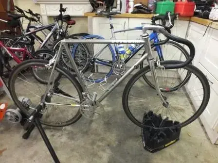

Couple of photos of work so far.
Handlebars have been changed to Deda Elemnti Speciale 42.
Groupset Campagnolo Chorus 8 speed.

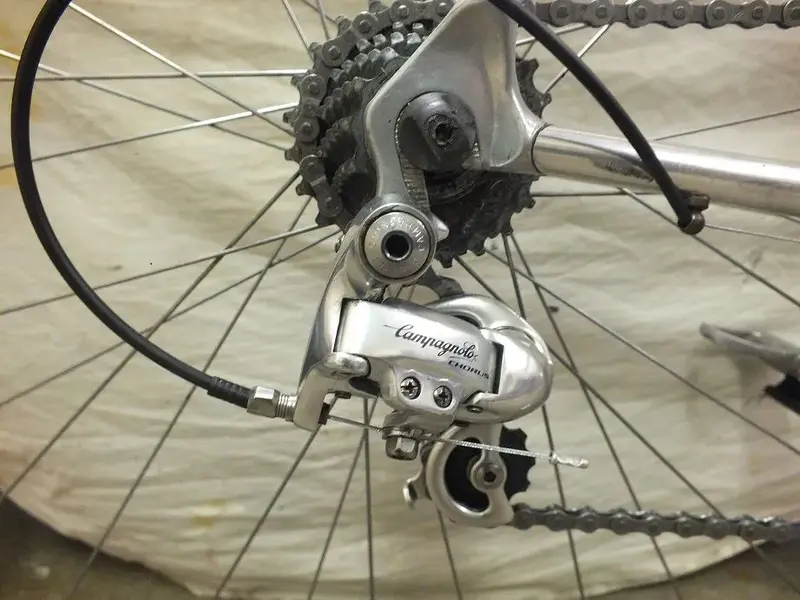

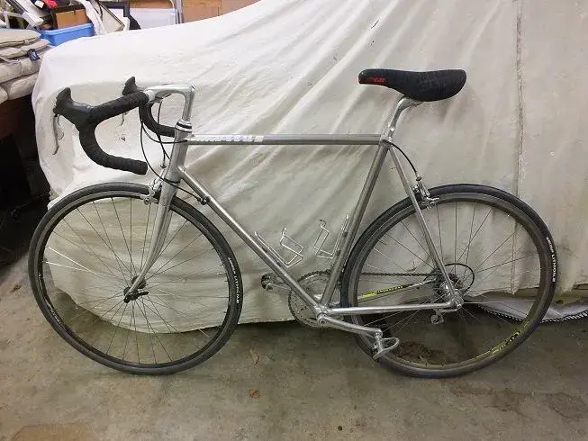

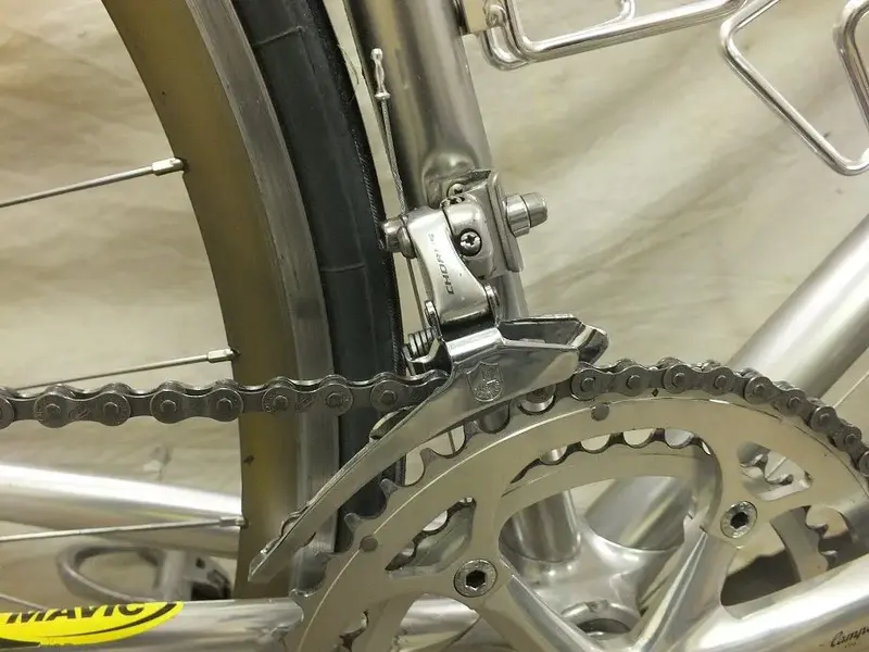

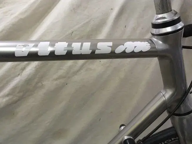

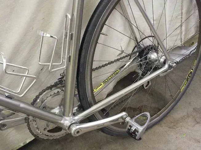

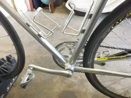

Got a bit more done today, it looks nearly finished now. The seatpost screw is holding up for the time being..
The groupset is Campagnolo Chorus 8 speed...
Handlebars are Deda Elementi Speciale, with BBB tape ( LBS does lots of BBB stuff ).
Pedals are an old pair of BBB SPDs which came on another bike but look the part..
Not many of the original transfers left, like the Mavic Equipment one. Not sure about putting on repro transfers , quite like the understated look of the bike with the bleached original Vitus transfers.
Cages are BBB (LBS again) aluminium, costing €5 each, couldn't be better.
Now to get a few kilometres under my belt on it.
Total weight as seen is exactly 10kg, 0.4kg lighter then my wife's 2014 Giant Defy 3!!

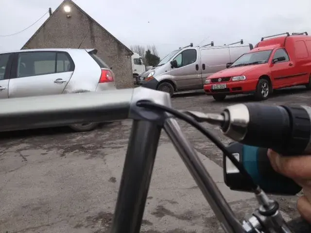

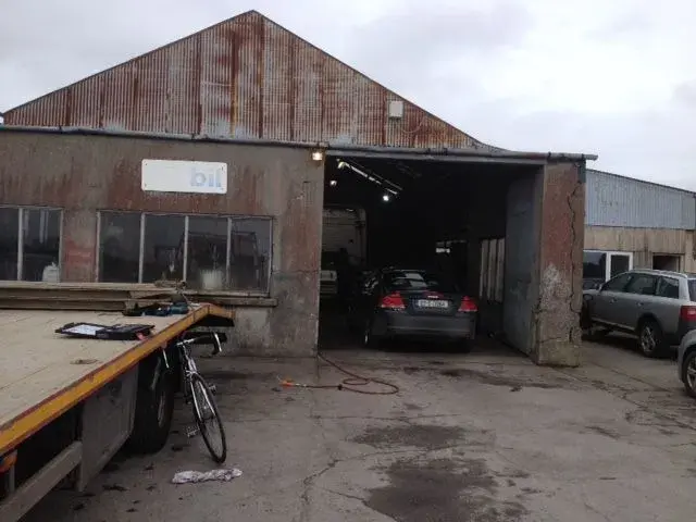

Went out today on the Vitus hoping to do about 50k, but after about 15 minutes, the saddle started to move, as the grub screw loosened due to the damaged threads. So turned around, and cycled about 1k uphill out of the saddle to a local garage to ask if they had a Helicoil kit.
No problem, but advised using Thread Sert instead. And he duly drilled out the lug, and fitted the Thread Sert.
Job done in less then 20 minutes and off on my way. Wouldn't take payment either. There are some great people out there!!
Maybe not for the purists, but a better job then the original.

The insert is threaded into the lug of the bike and Loctite used to secure as well. Won't budge.
