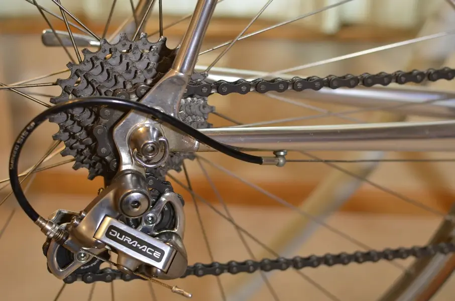

I see you have not been here in a while....hopefully you are well and riding this beauty. I have a 1991 Vitus 979 full Dura Ace originally, where I have added Ultegra sis 6600. There seems to be something missing on the chainstay cable stop... perhaps a ferrule that was integral to that stop or an additon. I note you mention something like this here, "on order". Can you give be more information about this? The pic shows what I believe it looks like, but mine lacks that ferrule / extension. If this entire stop is a unit and screws in, where can I get it. If not, is there a ferrule that will work with the 4mm outer SIS cable, and keep the cable lined uo properly??
Many thanks from Canada!
It's just a stepped ferrule - they're are available in all sorts of internal/external diameters and lengths, it's just a case of finding one that fits your requirements.
Thank you... learning as I go, cause the younger guys in bike shops have zero idea haha
Can you tell me what the ID is of the cable stop. Tech guy here was sure that the ferrule was integral to the cable stop, but pictures of new frames disprove that. He then told me he thinks the ID is 5.5mm. If so, then the ferrule would have a 4MM female end for the cable and 5.5mm male cable stop end???
If I can determine this I can go looking for the mysterious ferrule!
Grateful!
Grateful!

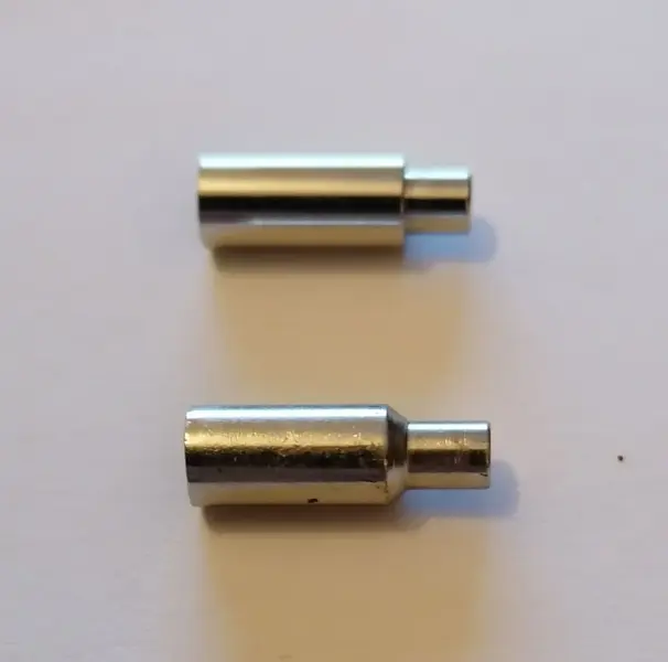

Had a quick measure with a tape measure, and the ID is approximately 5.5mm the smaller OD is approximately 3.5mm.
