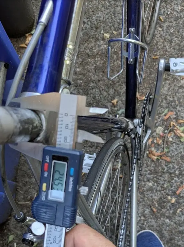

Bonus: I went to adjust the saddle height, assuming the seatpost would be seized up. Instead, when I backed off the set screw, the seatpost slid down into the seat tube without any pressure - like it's too small. I borrowed some calipers from our tool library and measured the outside diameter of the seatpost as 24.5 mm...how weird is that? Was that ever a standard size for a seatpost?
So I guess I'm in the market for a 25mm seatpost. At least it wasn't seized up, that would have been a much harder fix.

Seatpost is 25mm. You can buy them new. Don’t use that undersized one, especially if yours is an earlier frame with a pinch fixing instead of the grub screw 👍

Got it on the seatpost, the frame has the set screw / grub screw setup and that lug at the top of the seatpost looks fine, so no harm done yet, but I'll definitely get a properly-sized seatpost. (Side note: I've always heard this arrangement referred to as a set screw, but when I started looking into Vituses [Vitii?], everyone calls them grub screws. Go figure.).
