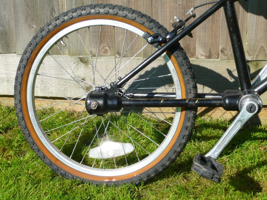

Vintage Walens Trident Shaft Drive Bicycle? Any Clues?

Some places I am reading that shaft drive with bevel gearing is less than ten percent less efficient than a properly fitted and lubricated chain. I wonder what the deficit is with belt drive?
Belt drive is practically as efficient as chain now I think, but I imagine that chain efficiency (well into the 99%s I thought :? ) diminishes more rapidly in the gloopy cack.
Only a few motorbikes use shaft drive, partly because of the weight but mostly I think because of the way it delivers power - twisting or squatting the suspension.
Somebody will give a much better account of that any moment now I'm sure! :oops: :lol:
I don't think RWD (Right Wheel Drive) BMW's use 10 times more fuel than FWD Audi's, where are you getting that from, LOL? Gears are typically very efficient!
Bevel gears have larger losses than a well-maintained chain system. While throwing away 10% of the power on a motorbike may be acceptable (and typically they only have a single set of bevels as the engine is usually rotated) it's a big hit on a bike.
Shaft is OK in a bike that would be poorly maintained, otherwise a disadvantage.
Interestingly, the Danish shafters reckon their bevel gearing is 10% MORE efficient than an 'average' chain and sprocket system, in terms of transmission loss.
Damn lies I reckon. (Just my opinion.)
Shaft drive motorbikes come in all flavours, and are generally well sorted these days. My oldest one was an early eighties Kwakker when i was dispatching. Had an old airhead BMW with the paralever, that was pretty sorted. Not really performance bikes though, but plenty doing the shaft thing now very well indeed.
