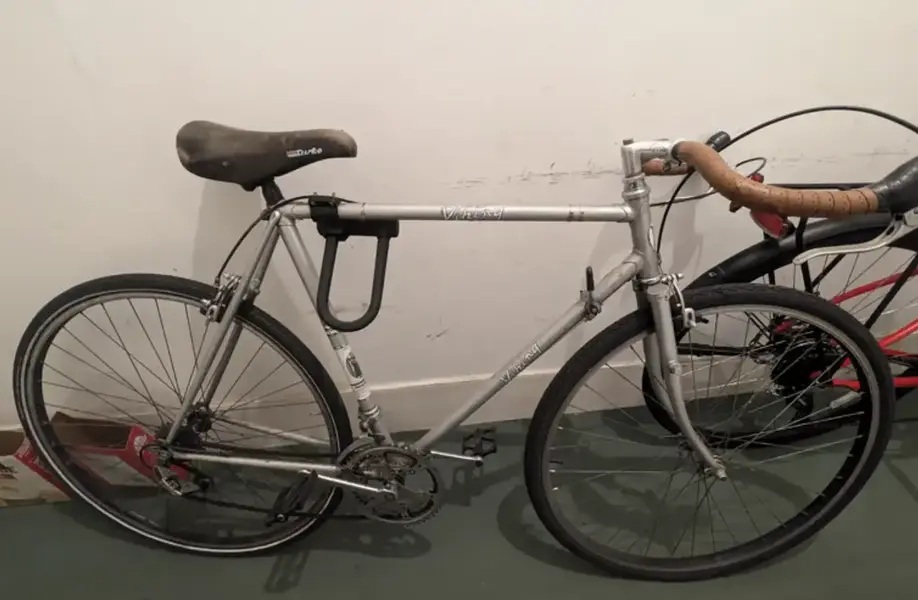

Hey guys,
Trying to get a budget old bike to give it some love and keep it going :)
Found this bike was wondering if it's too old to old to use modern parts for maintenance / and 700c conversion. Any thoughts??

cycle's Huret Challenger rear gear mech launched 1974 so if taken to be original it provides one date bracketing marker
suspect wheels not original
machine a pretty low end model
the investment in parts/consumables to make a refurbishment could easily put it under water with respect fo value
suggest you might wish to wait for a better candidate for your labours
trivia - fork crown is Agrati model N. 005.8028 from the Agrati "ROMA" lug ensemble Nr. 000.8020/E/U (IT)

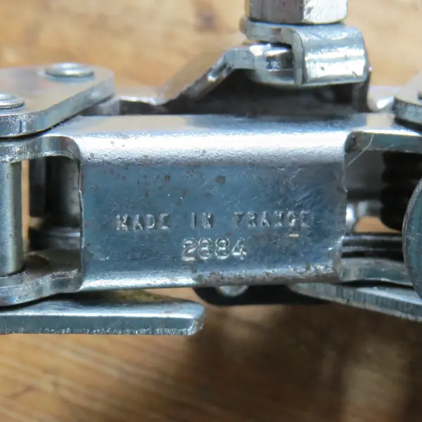

Huret began date marking their products in 1978 with a four digit numerical mark
here is an example -
this indicates the item produced during the twenty-eighth week of the year nineteen eighty-four
so if the cycle's three Huret components lack this marking you know it was constructed no earlier than 1974 and no later than 1977
Great, Thank you so much. Could I ask you another question? I was wondering if I could change the BB and the crank set to a modern one. What should I check for compatibility? apologies if this is a rookie question,,
Changing the BB and crankset to a more modern one is no problem, as long as it's a system that uses a threaded BB like Shimano Hollowtech, for example. Thankfully the thread on a BB is something that hasn't really changed over the years. The only thing would be that you do also need a specific tool to install the new BB. Depends how modern you want to go, partly - and why you want to change the parts. More modern parts will certainly be better and easy to maintain, but whether it's worth the effort involved compared to just buying a more modern used bike to begin with is debatable.
Essentially, before doing anything @juvela is spot on and so it's worth thinking about what you're going to use the bike for and what you really want to end up with before spending much money - this is a pretty low-end bike, as mentioned.
