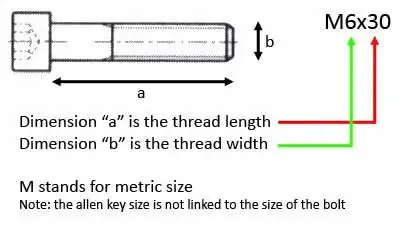

found this a little while back , may help
