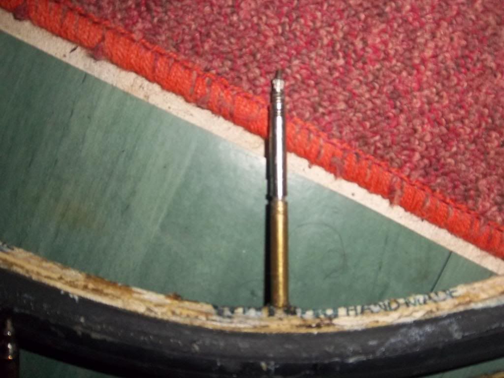

Here is the extension
I do not want to mess about with this too much as the tyre is worth some money.
Richard
The silver extension should just unscrew from the stem. If its got flats on it, small pliers will help. If no flats, you may still need the small pliers, just grip lightly tho! It's a very small thread, in brass, so unless they've glued it in it shouldn't take much to get it out. You'll need to hold the stem too, so it doesn't twist/damage the innertube.
The threaded bit next to the valve tip may well have two flats on it as well, if it does, you can unscrew that from the extension, and use it in the stem. Or just get a new one (they were about 10p from the LBS last time i bought any)
Thanks for that. I am pretty sure it is not glued as there is plumbers tape (i think) around the join.
Richard
Yup, thats a common trick to minimise the tightening torque. Some of the more expensive extenders have a ring of teflon to help with sealing.
