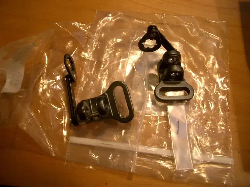

holden":msqz5igf said:
The linkage image highlighted earlier can be a problem but Shimano does make a rebuild kit for that section, about $15-20.
this is true but they have to be sure to get the kits that's not just shims, but the parallelogram linkage as well.
the kits that comes with shims alone doesn't keep the brakes from rattling up and down.
also, the shim kit can tend to introduce drag at the arms. so i've found it's best to replace the link. cost about twice as much but works better i think.
yeah, i was thinking the rebuild kit with the link arm. didn't realize my price quote was low.
i've attached pics of the kit.

OrangeRetro...it doesn't require that you strip them down but you could if you wanted to.
holden....depends on where you are. we have a set at the shop that's priced at $45. but shimano spare parts are always expensive.
what you have is a pic of the complete kit.
there is another kit that is only the shims.
