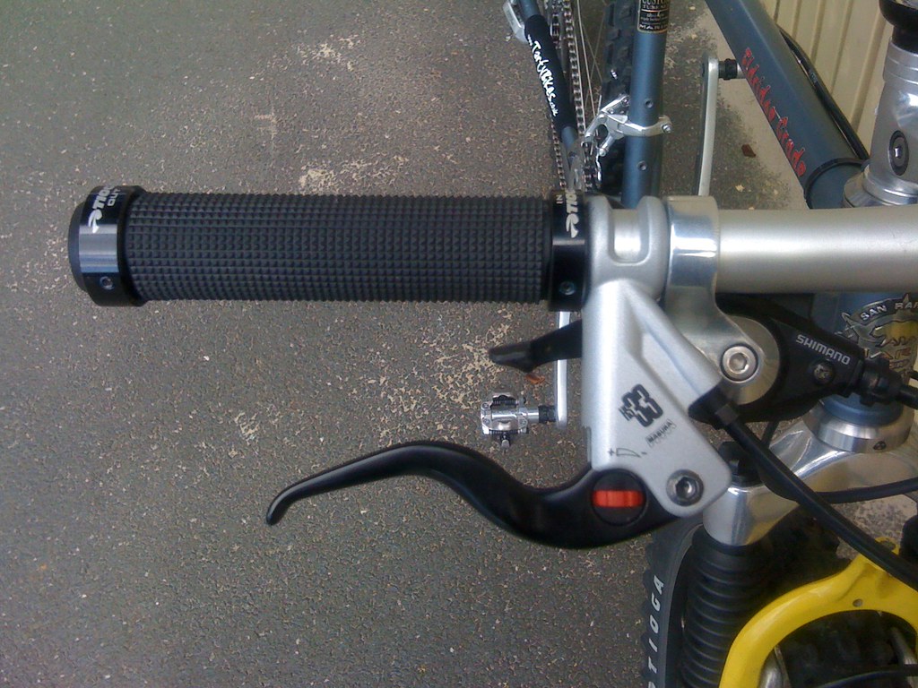

I love my new HS33 levers though <3
Plus they look shuper shexy with the polished calipers too
