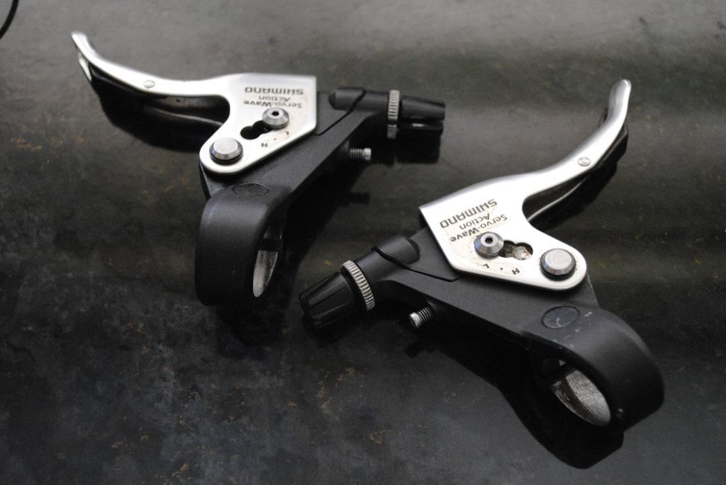

Are you using LX V levers with adjustable leverage like the ones pictured below?
If you are then the amount of cable pull can be adjusted to work fairly well with cantilevers. I think you just need to set them to the 'H' for high pull leverage to make them work with cantis. Could be the other way around though.
I'm not 100% sure...
No, bog standard Deore V-Brake levers as below...
...all I've changed is the front V's for canti's so far - the rest of the setup is the same.
