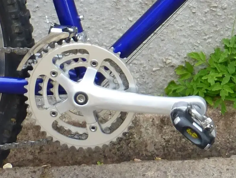

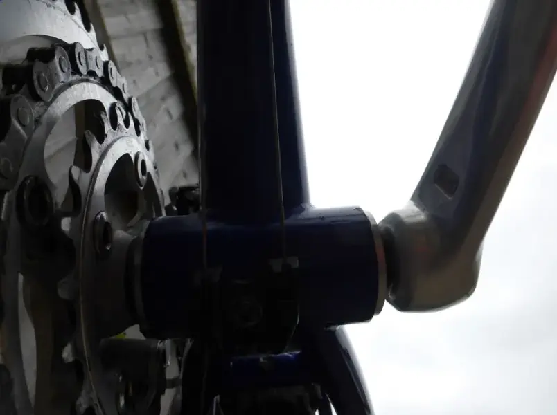

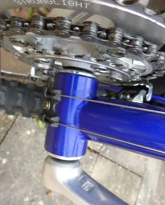

I have an Spa XD2 chainset on one of my mountain bikes, purchased as I wanted a decent chainset with 172.5 cranks. The XD2 is rather good quality with a nice almost older Campag polished finish. I haven't notice any undue flex with mine or any chain ring alignment issues either (mine has Stronglight rings fitted). I run as a triple using a UN55 113mm bb. Depending upon your chain stay design you may find that this length will also work for a double. I have attached a few pics so your perusal..

I too think it is a good looking chain-set. Mind you compared to most fugly modern designs it is not a hard beauty contest to win! Given the option I would always go for a 'normal' 5-arm design but at the time this is all Spa had. In practice it has been fine although I always Copaslip chainring bolts anyway but have heard that the hidden bolt can be subject to corrosion so something to be aware of.
