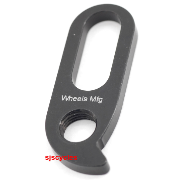

I knew I'd seen something cheaper:
£14 from SJS.
Should be able to fit that under the QR skewer, or the axle bolt.
You'd then be able to fit a stopped derailleur, or a Rohloff tensioner to take up the slack when you're on the small ring.

Thanks for that, I had seen the shimano SIS type on ebay but thats nicer.
I've got a cable guide, just the rest :)

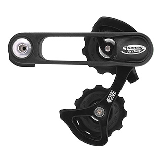

That Rohloff one is pretty pricey, too £55.
Have a look for the Sturmey one:
£26 here, $30 from States...
