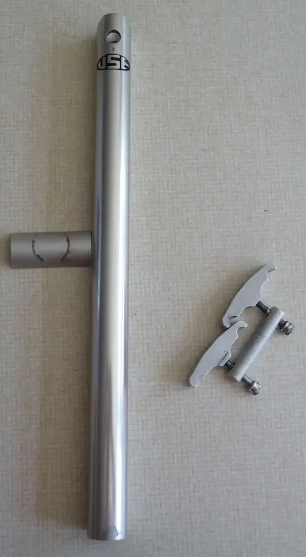

Mr Panda PoTM Winner MacRetro Rider Feedback View Jun 14, 2009 #1 I've unearthed a USE seatpost in a box of bits i was given 170g for the post alone, 235g for post and top clamp. 25mm by 400mm. Aluminium or Titanium :?: How do I tell?

M militiacore Dirt Disciple Feedback View Jun 14, 2009 #2 I'd imagine the aluminium will be fairly thick, more silvery in colour and smooth. The titanium will have a slight tinge to the colour and little bit of a grain or texture to it.

S Sithlord Old School Grand Master Jun 14, 2009 #3 From the weight it sounds like Alloy, as I remember the Ti ones being lighter
Xesh Senior Retro Guru Feedback View Jun 14, 2009 #4 The alloy post is a bright silver (see pic below) whereas the Ti one is no where near as shiny and is a silver/grey-ish colour. Attachments USE01.webp 50.5 KB · Views: 621

shovelon Senior Retro Guru Jun 15, 2009 #6 That looks like an alum post. I bet the tube wall is about 2 mm.
