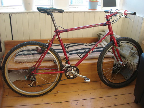

Hi All
1st retro build is complete - need to get some pics once my Laptop / camera are working again
Spec for the '94 Raleigh Gate is as follows
Frame: Raleigh M-Trax 1000 Ti Top and Down tube 21"
Fork: Raleigh Rigid
Frame and Fork are finished in a lovely burgandy with white decals - little patina and a few scrapes - character building!
Headset: DiaCompe Aheadset 1 1/8" - original loose ball bearing!
Stem: Raleigh 1 1/8"
Handlebar: Raleigh Steel
Grips: Unknown
Barends: None
Brakes: Deore LX 563 Canti
Brake Pads: Deore LX Canti
Brake Cables: Shimano
Canti cable hangers: Shimano Link Wire Rear - Onza Chill Pill Front
Brake Levers: Deore DX ST MO71- Pod mounts removed
Shifters: Gripshift SRT X-Ray 800 - Red Yeti Grips
Front Derailleur: LX 563 31.8 TP
Rear Derailleur: LX 565
Derailleur Cables: Shimano
Cassette: XT 737 8 Spd
Chain: SRAM
Cranks: LX M565
Crank Bolts: Shimano Steel
Chainrings: LX M565 22 - 32 - 42
Chainring bolts: Shimano
Bottom Bracket: UN90 68*113
Pedals: Shiman SPD M525
Hub Skewers: F) Hope Steel, R) Shimano XT
Rims: F) Mavic 231 R) Mavic 231
Hubs: F) LX 563 R) Hope Mono Red
Nipples: Brass
Spokes: DT DB
Tyres: F) Panaracer Dart HC 2.1 BW R) Panaracer Smoke 2.1 AW
Tubes: Continental
Saddle: Bianchi Selle Italia Flite
Seatpost: Deore XT 27.0
Seatpost Binder: None - bolt has been snapped off - post fits very snugly but can be removed as required.
Not bad for a 1st attempt I think, I'm going to try and get it on the scales as I estimated 27 lbs which I think might be way too heavy...

Pics at last....
Front brake cable has been swapped for an Onza Chill Pill and the front tyre is now a Panaracer Smoke Amberwall in 2.2

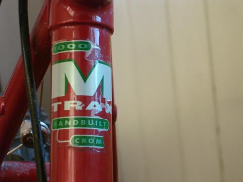

After over a year of ownership I decided to check with a magnet and neither the top or the down tube are magnetic.... Assume that means it's ti!!!
I'm beginning to think it's been repainted and had different decals applied....
I found an advert which has the 94 m-trax range and the only one which had LX as standard was the 3000...
So it may have been repainted and changed decals job...
The lugs are steel as is the seat tube and rear end but the top and down tubes are definitely not magnetic!!
The cable stops are also riveted on which makes me suspect further...
