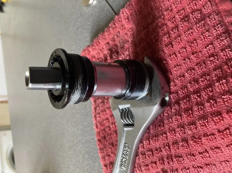

Woz - thanks for your replies. Super helpful. Absolutely no chance of knocking it off easily, and I've tried a few less than delicate taps with the multi-purpose persuading tool and a wide spanner across the flanges. It is well and truly stuck. Have rested it in an adjustable spanner and soaked with WD40.
It's been fitted, but no idea how long it's been off a bike. Might resort to seeing if my father in law has a puller, as I'm not known for my patience in such matters.

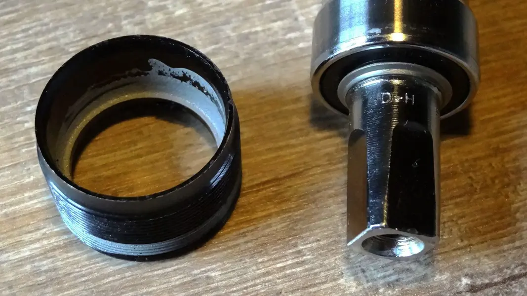

Screwed the NDS into the BB shell as far as I could get it to protect the threads, and with an old crank bolt in to protect the axle. Then gave it a gentle tap from the other end with a hammer and drift. Nothing. Then a bit harder. Nothing.
Eventually I gave it a bit of a wallop. Nothing. To be fair I then had to hit it pretty bloody hard, but it's out. On retrieving it from the other side of the garage, where it had jettisoned itself (doh - should have thought about that) I have thankfully not damaged it, but there is lots of crusty dried gunk in there that had stuck it together - likely the rubberised stuff mentioned above. Cup unscrewed beautifully so no damage there - it must have been mounted to a garage queen as it really is pretty minty fresh.
Bearings still spin beautifully. So now to clean it up, and the build progress can continue.
