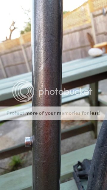

I've got hold of this today and I'm just wondering what the frame is.

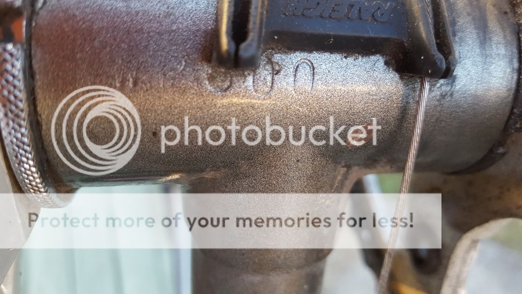

Cannot properly see the serial number through the paint but it's "WR 600" or similar. Nottingham November 1986 perhaps?

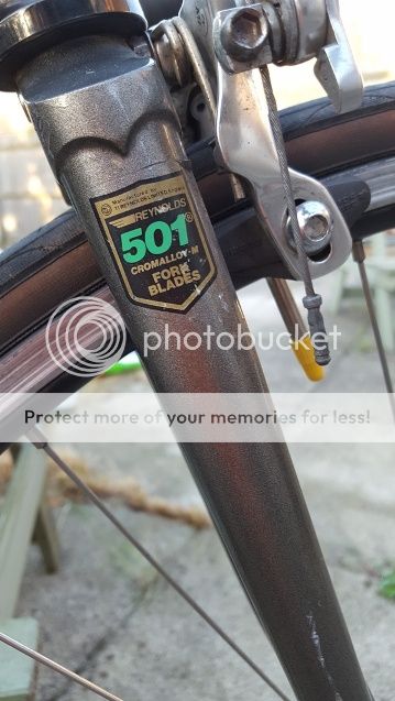

I think the paint is original but it may not be at all... are the "501" decals original?
There is a vestige of the word Raleigh down the seat tube which are indented as if someone has peeled of stickers/decals
I know this isn't a lot of info but I'm hoping someone can shed some light.

kermitgreenkona88":2dawx6zt said:
WR600
Worksop
November
1986
Thanks.
I thought Worksop closed in 1981 though and the "W" was transferred and retained at Nottingham for a while...
Matty :)
I have a late 80s Kelloggs which is 501 tubing and the lugs on that are far "chunkier" than these.
The seat post is 27.0 mm by the way which may be a clue?
I know the 531 standard is 27.2 mm
Thanks
Matty :)

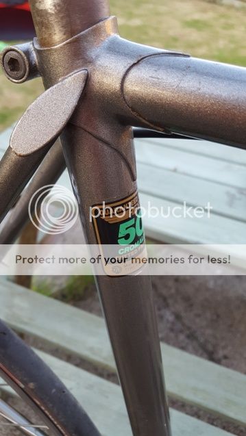

I also note the rear stay to seat tube attachment is like the 653-framed "Record Ace Moderne" I used to have...
The way the stays are attached on the 501 Kelloggs is far more "rough and ready" without what appear to be the little tear-drop shaped "covers" at the top of the stays.
Matty
I'm now fairly convinced that this is a refinished "Team Corsa 12"... but... did that model have the "pip" on the rear of the head tube?
So many questions ;)
Matty

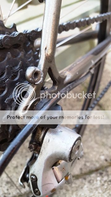

Matty
No it didn't have a pump pip and it didn't have mudguard eyes on the dropouts either :(
