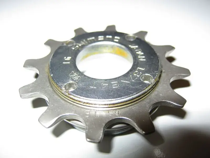

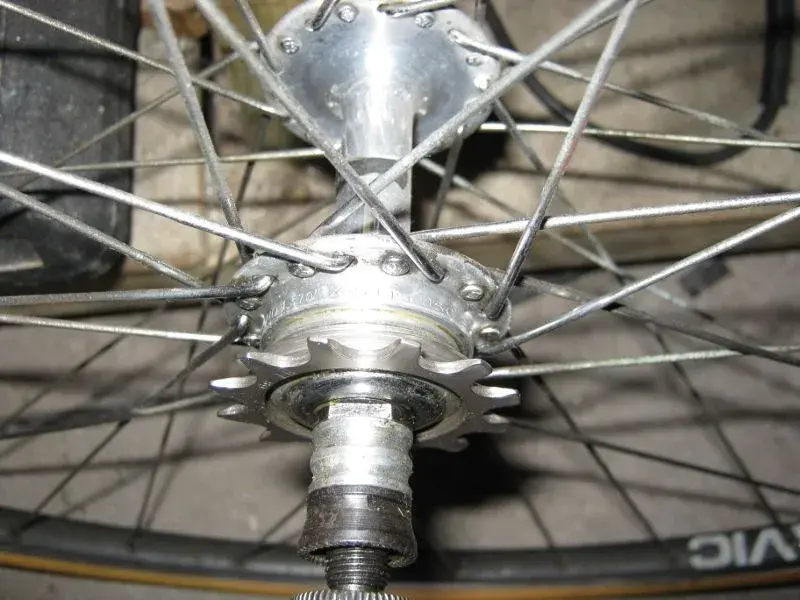

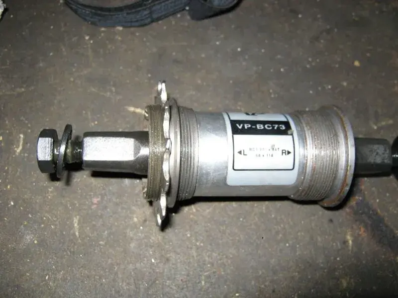

Well, the sprocket went easily onto a Shimano DA hub and a chinese BB but got stuck after about two turns onto a good ol' Super Record. :lol: :roll:
