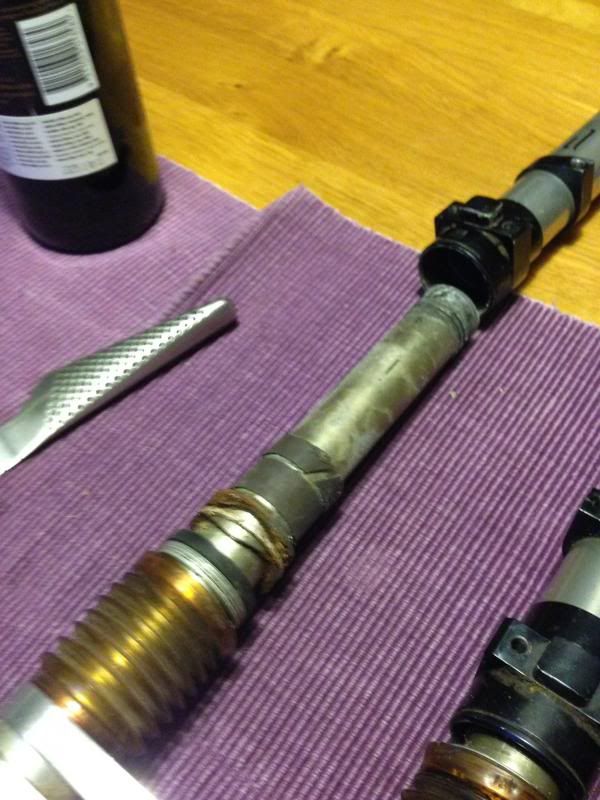

On first inspection it didn't look good. They wouldn't budge an inch and I almost put them aside but I persevered and after several soakings with GT85 and some brute force (really; I thought I was going to destroy them at one point!) they finally came apart.
I was shocked at what I found. Rather than a total disaster the internals didn't seem too bad. Old grease had set like concrete and the original elastomers (same as in their seatposts) were mush but the seals and bushings were saveable. I started to think that all may not be lost….
After some serious cleaning and sourcing some new elastomers I was finally able to put them back together and they worked!!
I need to get some slightly thicker o-rings for the LHS leg so that they hold air (They have elastomers in one leg and air in the other) but otherwise they're working beautifully.
