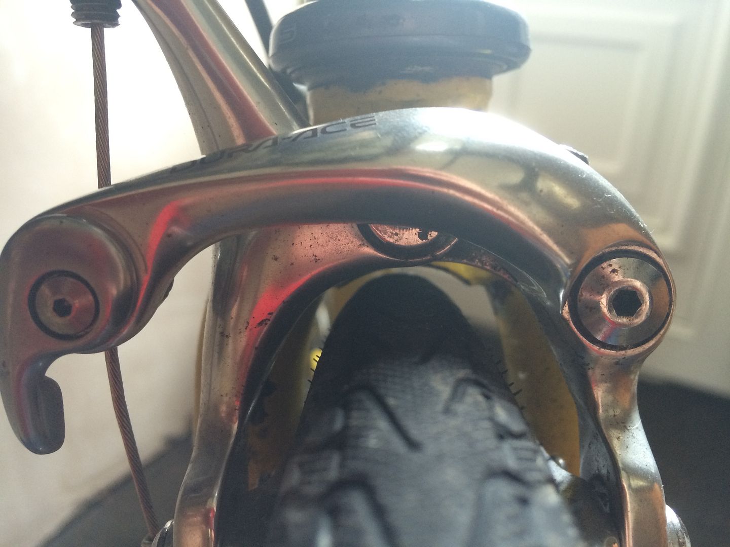

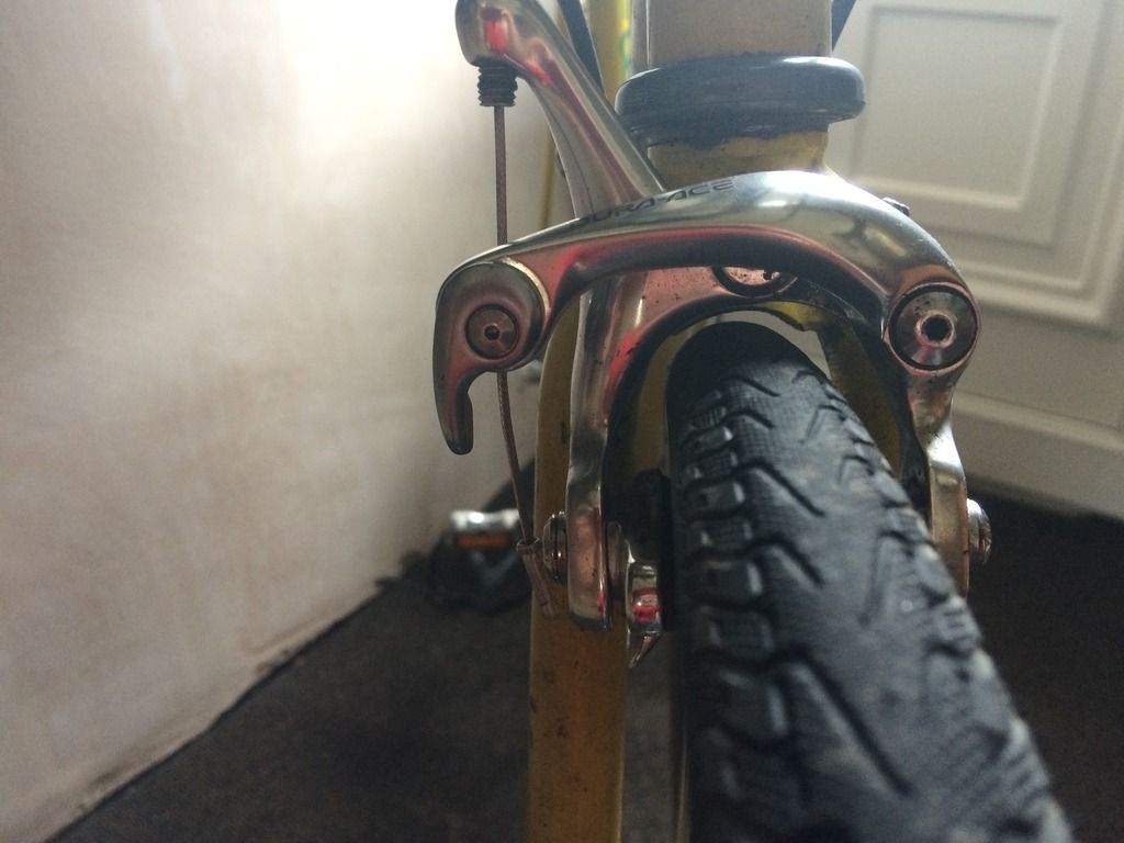

Going to be doing some riding on gravel roads soon and was thinking of fitting wider tyres to my Graham Weigh. Going by the pics below what are my chances of squeezing some 700 x 28s on there?
Currently fitted are Panaracer TG 700 x 25. Looking at either Panaracer Gravel King or Continental GP 4 Season. Any advice at all? Oh, the rims are Mavic CXP 22s by the way.
Cheers!
Panaracers always seem to come up small -so I would try a 28mm. However, 3mm is not very much clearance and you are running the risk even of a bit of gravel jamming the wheel. I've had it happen with a mudguard, and it's not pretty. :shock:

Good point! I've got to balance (he he) the advantages that the wider tyres will give me on gravel with any risks I suppose...
Looks like I'll have to go ahead and purchase them and then maybe them not fitting. (So look out for them on here if they don't! :lol: ) Before I do, anyone running the Gravel Kings in 28? I know that the GP 4 Season are also well regarded: So which to go for? Does anyone here think that changing up from 25s to 28s might not actually make that much difference? My folding TGs haven't had that much use. By the way, I'll be riding 'normal' roads as well ofcourse.
