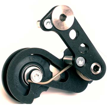

one of these:
Well that will work too. I used an old LX derailleur at first before the Rohloff. You just need to put a bit of cable between the cable crimp bolt and the bit where the cable goes into the barrel adjuster at the back of the mech to adjust the derailleur to the correct chainline position. I used a bit of brake cable which had the lump of metal at the end of it so the cable doesn't pull through. Hard to describe!!

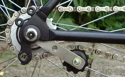

Or you can make a super cheap one like this, one piece of mild steel, bent, shaped, drilled + one old pulley and a bolt. Cost? Nothing!
