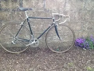

I'm putting an 85/86 TVT together. It's the carbon Kevlar type with matching forks. I have an early dura ace groupset and a shimano 600 groupset. Which would be correct? Also any info on these frames would be appreciated. I don't seem to be able to post a picture as the file is too big!

Thanks for the info. Thing is my frame isn't the black carbon! It's a green: blue tinge with the Kevlar weave showing through. I'm thinking it's an early model but really don't know. It had tvt stampeded on the stays and drop outs.
Ok... I'm still having trouble with better pictures. The green/ blue colour isn't like baurs bike( that's painted) . Mine is clear coated over the carbon/ Kevlar.
Anyway numbers on the b/b are... 54 which i presume is size and then there is TVT 080286088
Any ideas?
Well if the serial format matches mine, yours is 08-02-86 - 8 Feb 1986. But I'm just making an educated guess and that date does seem old. The other number on mine is TVT58I, which is 58cm, Italian thread.
