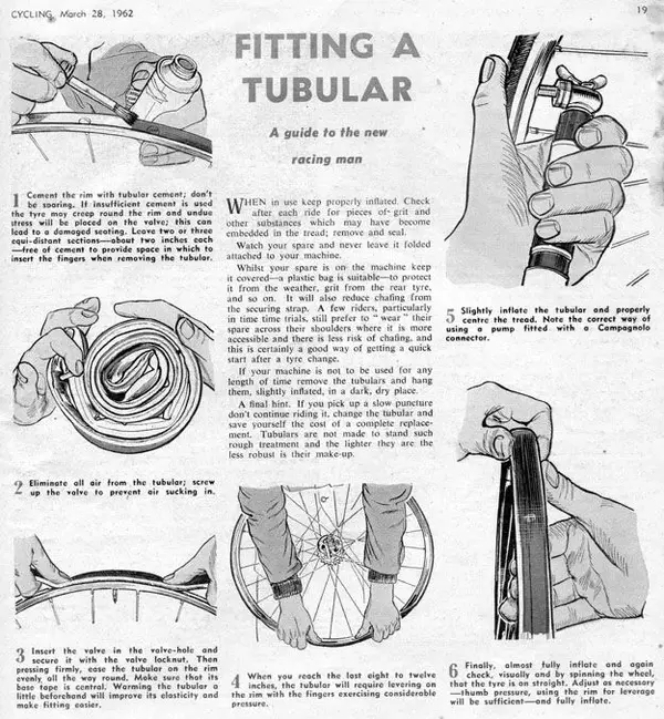

Here we go, the old 'Cycling' page on how to fit a tubular. Now I've looked at it it does seem to miss out quite a few of the basics that we've already mentioned - eg. pre-stretching and inflating dry on a rim, warming slightly, a coat of cement on rim AND tyre, but it does show how to get all the air out - which makes life easier. I do this prior to folding up my spare to go under the saddle and I do it to innertubes as it makes them smaller and easier to fit into under-saddle tool/tube bags.
There was also a similar set of drawings on how to repair a tubular but I've not come across that one yet. The original one I had I cut out of the magazine and stuck to my shed wall when I was a lad.
