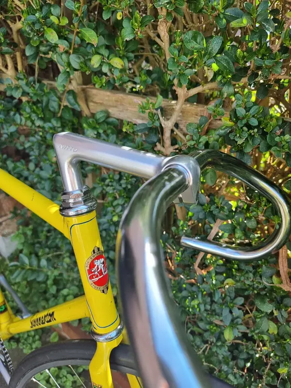

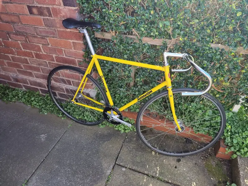

Here's a picture of the bike last spring once I'd swapped the first few bits, if that gets anyones juices flowing (it came to me with Cinelli XA stem and Criterium bars, gipiemme wheels, Tange headset, selcof seatpost, Mavic cranks and a Record Pista BB, and I've currently got some borrowed Dura Ace/Ambrosio Nemesis wheels in there). It now has a nice Brooks Swift Special on there too for extra retro
