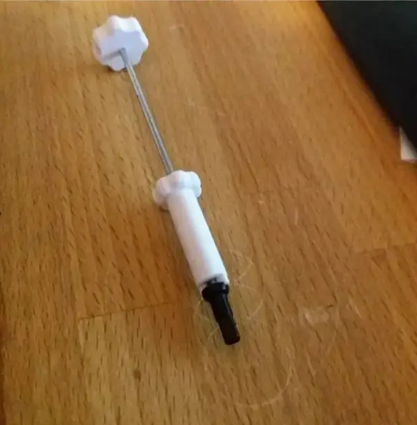

thanks synchro and novcaine will watch that properly later. The stand is probably fine but are the pins that go on the rim meant to be loose?
They move really easily

That's the bit I replaced with m3 or m4 (can't remember) screws. There should be a small o ring in there at the moment. I made some little ends on the printer. I'm not home right now but I'll grab a piccy later of my modifications.
