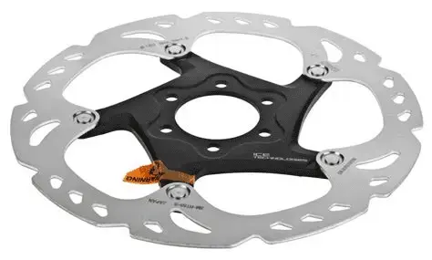

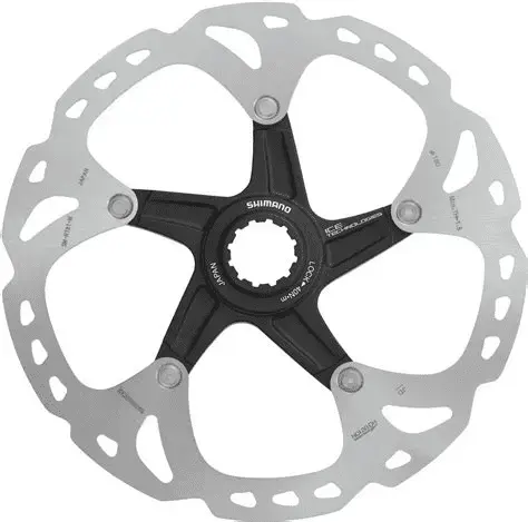

You can not use rotors with a rigid spider on BB7s. The whole principal requires the rotor to flex because one pad is in a fixed position.
Basically, one pad pushes the rotor toward the other pad.
How does one know if the rotor is rigid? Do I just give it a good squeeze and if it moves then it's flexible and if I'm on the way to the A&E with a nasty cut it's rigid?
Well.....This is a rigid spider. Matches cranks with proper 5 arms and shit:
Otherwise, it looks like it was pressed out of one of these or someone had a go with tin snips out of boredom:
