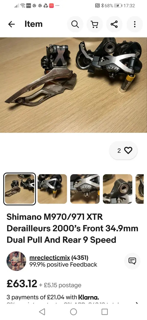

3x9 I'd recommend xtr 970
Likely will also shift 10 speed
Comes with shims
This beautiful works like silk
Needs 9 speed chain
