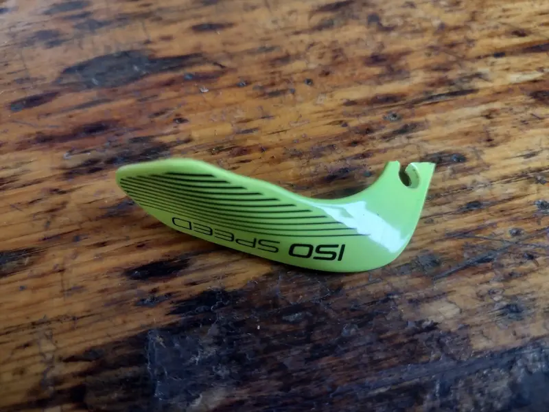

Isospeed cover thingy was broken, some people eh? 🙄
Much to my surprise, these are still available so I ordered one.

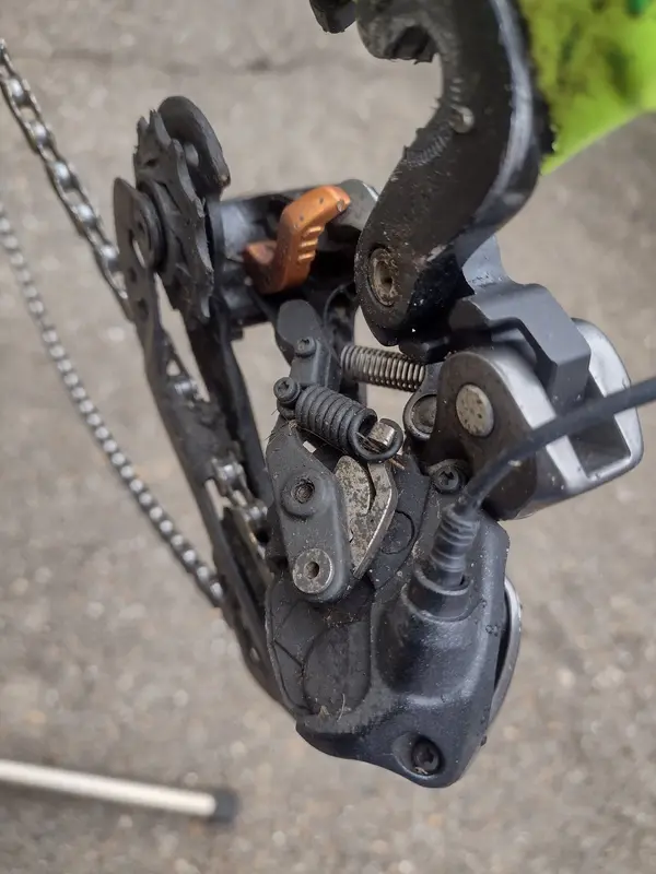

Rear mech need a bit of a clean as it's a bit grubby, won't take a lot to be fair and being an electric one, I can't allow it in the bath with the chain. Who knows what they would produce given the chance 😂

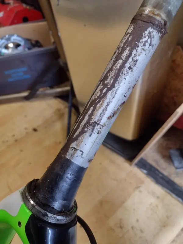

Next up was the notchy feeling headset, having noticed a bit of colour difference between the frame and forks. 🙄

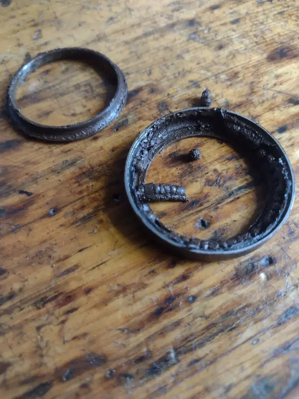

A bit nasty, expectations were low. Surprised to reveal that the lower bearing was in good condition so flushed and regreased that. Unusually, the top one was in worse condition. Well, to be frank, I've not seen a bearing this dead in over 30 years.

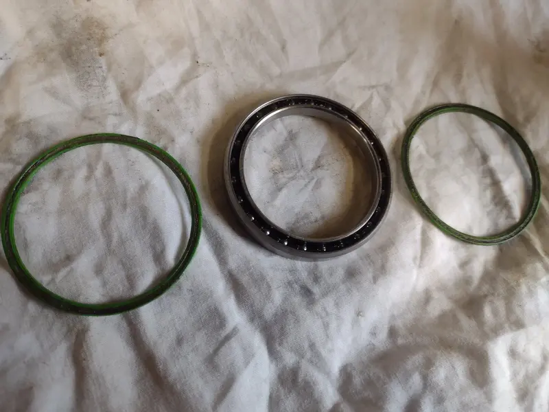

Thankfully, I had a suitable replacement so have dry fitted it all to make sure it's good.

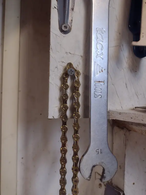

Goldie looking chain is now looking a bit more er, gold and respectable and drying out next to a retro tool. 😉

Last few headset bearings I've had to replace have all been tops as well. Seals are never very good and because they are still 1 1'8th, the actual ball bearings are tiny. Moving to tapered mean the bottom ones are 1.5" and the individual balls tend to be bigger plus there are more to spread the load. May not be a factor, but I wonder if being integrated into the frames now also shield them better from the elements.

The bottom ball bearings are actually the same size for this frame. Albeit as you say in a 1 1/5" unit.
