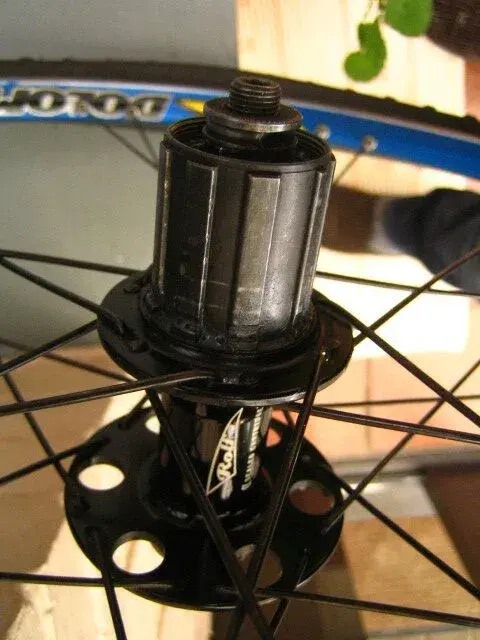

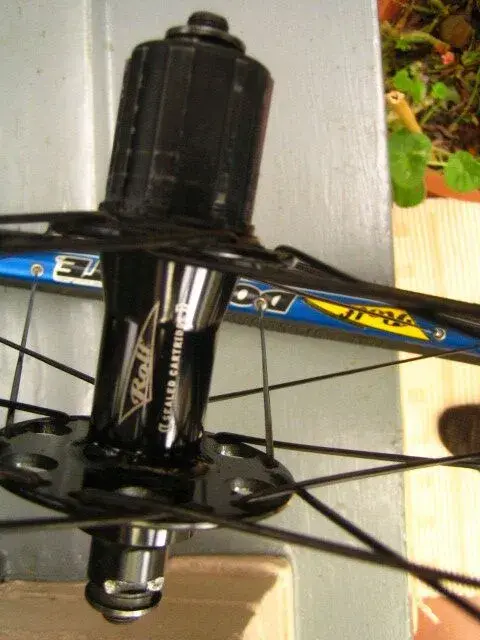

New here on this forum. I'm from Belgium and trying to restore a Trek Y33 equiped with Rolf dolomite wheels. The rear wheel hub suffers from some "play". ; Any suggestions to obtain some parts?

have you got a picture of the hubs which might help - some of these wheels I think had the hubs made by DT Swiss (Hugi)
Hi,
Sorry for the delay. Disasembled the wheel this morning.
Enclosed you will find some pictures.
Thanks for your help!!

Hi
I am pretty certain that hub is a DT Swiss/Hugi unit (also known as a Bontrager Race unit). These wheels were also built with Formula hubs but the exact times at which each was used is very hazy to say the least.
I have attached the manual for you - you need to be looking at pages 16 and 17.
Hope this helps.
Ade
