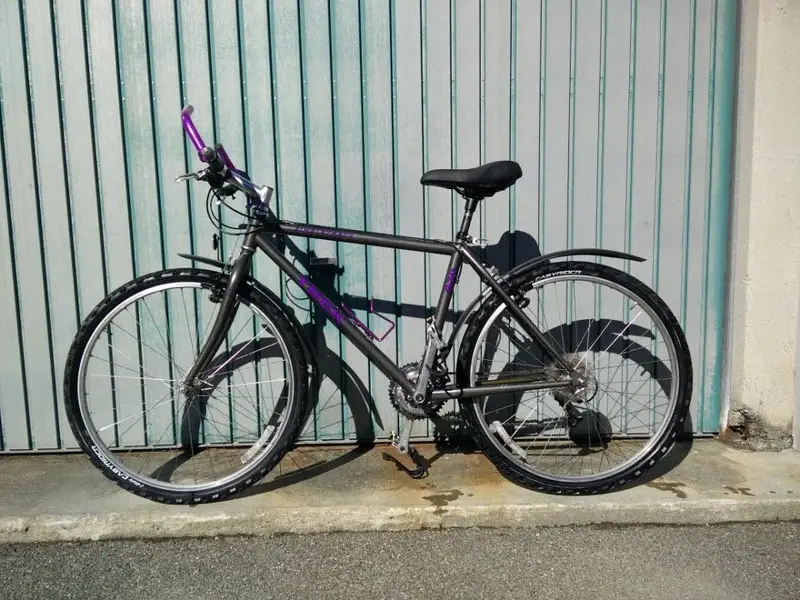

Hi Guys,
here my TRAK middle 90's , in very good state,with original color and decals,all parts are original.
Looks good? :mrgreen:
Before and After:
Congratulations on the bike! Looks very good and in great condition! I love Trek Singletracks so I'm biased...
If you want it for your wife, and if she's not a hardcore rider, a tip from own experience refurbishing classic bikes for my wife.
Replace the original stem for something much higher and much shorter. Retrobikes have a lot of interesting features, but comfort is not one of them, and non-cycling wifes around the world usually prefer practicality over looks, don't ask me why ;-).
The top tube is usually very long, and factory stems are also always over 130mm (modern bikes come now in the 80mm to 110mm range). You can always switch it back if you want to sell it. Bike will look horrible, but it will be used.

That stem is definitely an option. Ugly, but will improve the position.
A more elegant solution is to install a steerer adapter like this one
http://www.wiggle.com/bbb-bhp-2021-stem-extender/
And then a very short stem, something about 70mm maximum
This guy did something like that for his girlfriend's bike and it looks great given the circumstances
http://blog.peterlombardi.com/2014/03/o ... track-990/
Other alternatives instead of changing the stem is:
-get a downhill riser handlebar. You can easily increase the height up to 7cm
-get a butterfly handlebar, that brings the reach about 5-7cm shorter
https://ixquick-proxy.com/do/spg/show_p ... b2f2ca8e57
