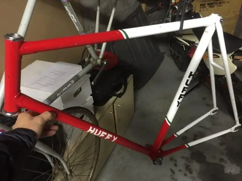

I need so help identifying a track bike i recently bought. I came branded as a Huffy I pretty sure it is not. The frame was resprayed(terribly) and the stickers were stuck on. If anyone can help identify the fram I would really appreciate it. Number's on the BB are F2316 and 427.

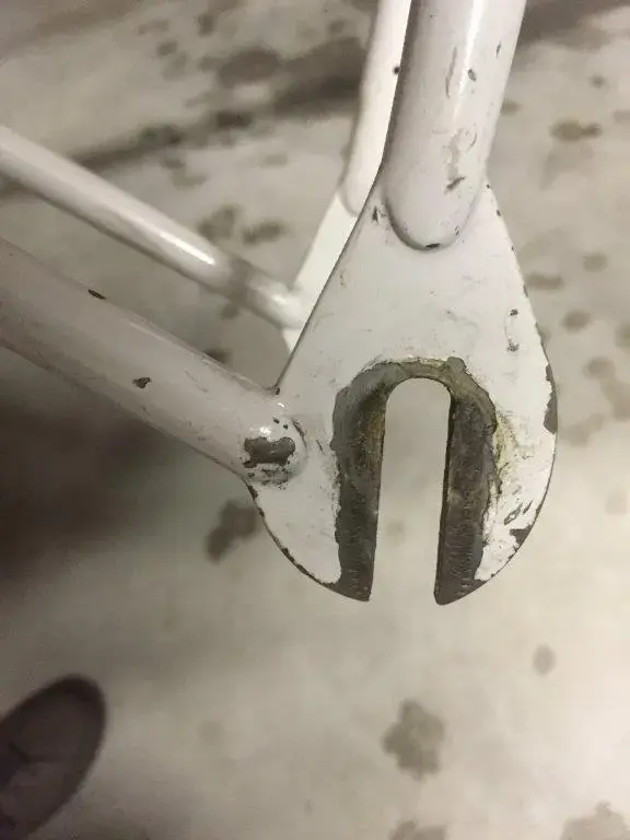

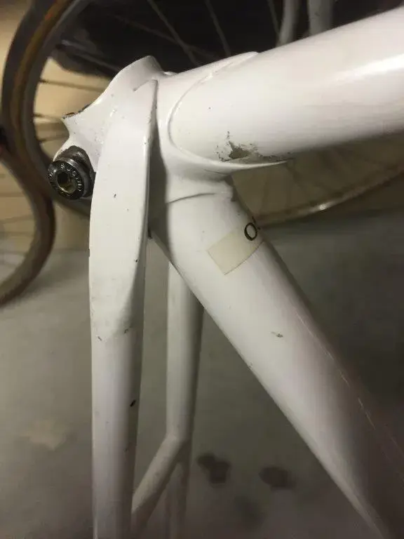

semi wrapover stays, Prugnat spearpoint lugs and lookalike (if not original) Campag. dropouts are very much the style of the 1960/70's.......nice frame but not sure of the build, do you have the forks as well as they would also have a serial number stamped on the steerer tube?
Griff
Classy looking frame, chunky rear end, fishtail dropouts and clean lugs ....... last time I saw something like that ridden in anger was at the 1978 Skol 6 :)
Can't help with a maker though, sorry.
