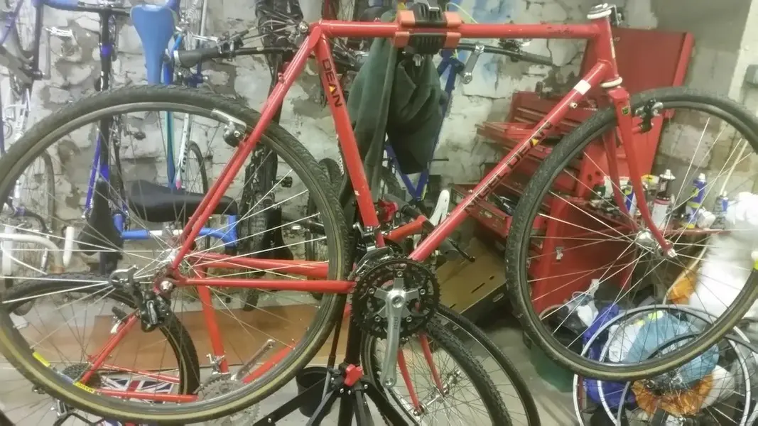

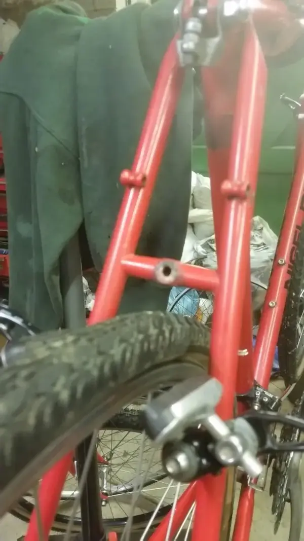

It's threads like this that get me in trouble :facepalm: I have a Nigel Dean Tour Ace F&F in the cave I was going to sell to my brother, since reading this thread now maybe not :oops: I have in the last hour been hanging shimano LX parts on it. It was originally built for 27inch wheels but it can take 700c which means I can use some 700x38s that I have. If it were to be built I'd have to build some new wheels for it to accommodate the tyres. But it's one of those builds where you have everything well apart from spokes in my case. I guess you don't really need anymore that a 3x8 on the gear front but wether to use drops or flats with bar ends for the bars if to use flats I could also use MTB combo shifters and levers which I guess amounts to the same as using a MTB tourer albeit with bigger wheels.

In my limited experience with my 'other' touring project (Trek 830 from the 1990's), 3 x 8 well selected gears are more than enough.

One issue that might be considered a bit of a disadvantage for a heavily laden bike is the caliper brakes, which are less common on full touring bikes, but I am sure that good, well adjusted calipers will cope perfectly well.
