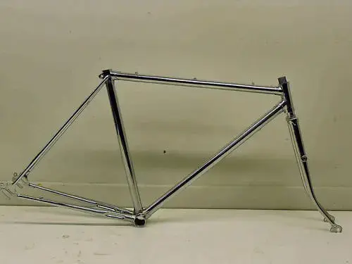

Blimey......a 70's chromed frame with the usual fudge of a bare cable for the rear mech and a bit of outer cable for the front :)
usually a sign of a classy frame for some obscure reason before they all went under the bottom bracket :)
Any more pics?

yep, you've got me there - those pics have been shrunk and moved from one format into another just to get them onto the thread - total pain in the backside - and it obviously didnt work! apologies for that. alas, no other pictures as I havent officially bought this yet and those pics came attached to an email as 3MB each.
Plan is to purchase this week so once it's here i'll post some images and some specifications i've been given - then the fun really begins trying to find the components at a decent price - that's where you guys come in - advice on what to install - i've got a dura-ace AX 1st gen rear mech that I think should be the basis for the rest of the build if it fits...the rest is 100% up in the air...should be fun :lol:
found one other picture...
first impressions / thoughts / ideas all welcomed.

regarding the frame that i've now bought, some further info:
has a 68mm english thread BB,
95mm front forks with 5/16" drop-outs rather than 3/8" - 27" wheels.
standard 1" 24tpi steerer but uses a 30mm headset.
22.2 handlebar stem
25.4 seat post size.
