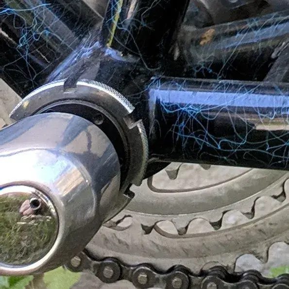

It's a cup and cone I believe. See here:

That's just great. Thanks. Was actually looking at the UN55 yesterday. I like the aesthetics of the chrome cup and cone that is there now. But it seems the UN55 is at least metal on both sides (not plastic on one side as the UN54). If the cartridge one seals the frame better and holds grime and road salt out, I'm all for it.

If you're going to fit a cartridge BB, you may be best off getting the old BB removed at a shop, rather than buying the tools for one use, or try to borrow some tools. If it's not too tight, you can bodge it using a hammer and an old screwdriver to knock the lock ring around then knock the cup around, but it's far from ideal. You also then have the problem of getting the other side off, which you can do with a wide jawed adjustable spanner, if you have one.
