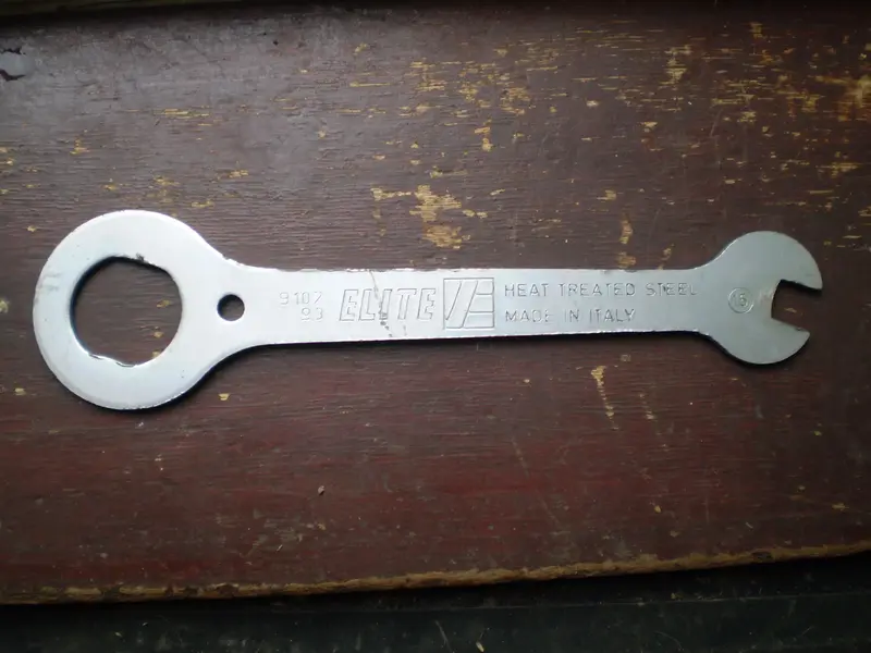

If we are talking thin plate 15mm open end, they never last. Even Campag. The issue is that our hobby brings home some right old badly treated knackered shit. The damage to these types of spanners on these stuck pedals is almost instant.
I'm using a ground down decent normal spanner with the other end cut off and inserted in an old pair of steel flat bars.

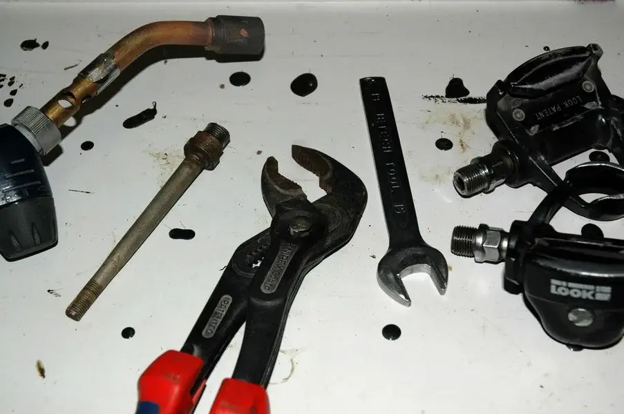

Pedal spanners never seem to last though, I'd like a recommendation here too please!
I have had this pedal spanner for years, it is still going strong despite much abuse. Can just make out the hammer marks in the top edge.
Agree with above, modern Park tools arent anything special imho.. All my good pliers are Knipex, spanners are King Dick and Draper, really rate my Fat Spanner bike tools, the workshop versions. Want to try some Wera allen keys but my cheap Draper expert ones are just not wearing out. A lot of my good tools that do the job well are all old, you tend to replace the crap through time and end up with some quality tools, regardless of name.
